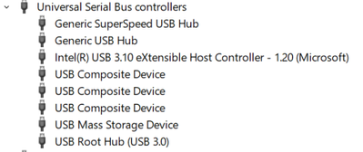

I have an HP 250 G9 and I purchased a hub so that I can have duel monitors. USB devices work on it fine, however, none of the displays work when plugged into the device.

It ONLY has 1 hopeless USB Type-C® 5Gbps signaling rate port which does NOT support Alt mode nor Power Delivery. You can NOT use it to
  • Charge your machine,
  • Connect to an external monitor with/without hub/dock/adapter
If you wish to connect 2 external monitors (only-total 3), you can use
  • Monitor 1: HDMI direct cable,
  • Monitor 2: Using a Displaylink Certified USB-A to HDMI adapter such as
                                     USB to HDMI Adapter
Other option (USB-A hub) :   https://support.hp.com/au-en/document/c05357751
