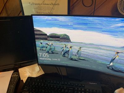

 An addendum. This is what the green, pixelated screen looks like. Note that the secondary screen (left) is blacked out. After restart, both were back to normal.
Hello @macanes
Scenario 1)
What happens if you connect different computer/notebook with a new display cable to monitor A or B ? Do you still have an error image ?
Scenario 2)
What happens if you connect the OMEN 30L GT13-1350st CTO with a different monitor (not A/B) ? Do you still have an error image ?
Please report your results.
best regards

1) Connected both monitors to my 2013 Macbook Air laptop with different cables. No problems noted.
Connected both monitors to my 2013 Macbook Air laptop with same cables. No problems noted.
2) I only have these two monitors to connect to my desktop.
Hello @macanes
The NVIDIA GeForce RTX 3060 should be replaced ( technical problem ).
The new/used card should have all graphic drivers for your windows operating system.
If you can't change the graphic card, have it replaced by a computer repair shop.
