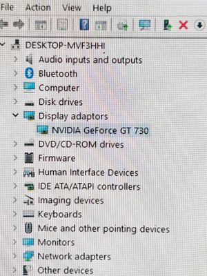

Hi Paul,
Thank you for responding.  I hope, I am looking at this correctly, do these photos help?

You're very welcome.
Your screenshot shows that your PC is only showing the Nvidia graphics adapter, which means that the onboard Intel GPU is disabled.
If you were to connect a DVI cable from the DVI port on the motherboard, you would not get any video signal from it.
The only suggestion I can offer would be to go into your PC's BIOS and see if there is a setting to enable the onboard graphics adapter while allowing the NVidia graphics adapter to work as well.
I am only aware of that feature being offered in the HP business desktop PC's but perhaps your PC may have the setting.
If not, you will have to use the available output ports on the GT 730 card and if there is only the one HDMI port you will not be able to do what you want to do with two monitors.

The picture you posted in the first post sure looks to be a video card output face.  Along with the conversation with Paul, it must  the GForce GT 730, which should support another monitor using the DIV output.

Hi, @TheOldMan
You are 100% right!
That does look like the GT 730 video card, and all that needs to be done is to connect a DVI cable from that port to the second monitor to extend the display.
Sorry for the bad info.
 I got the DVI to HDMI and it works great - thank you.
