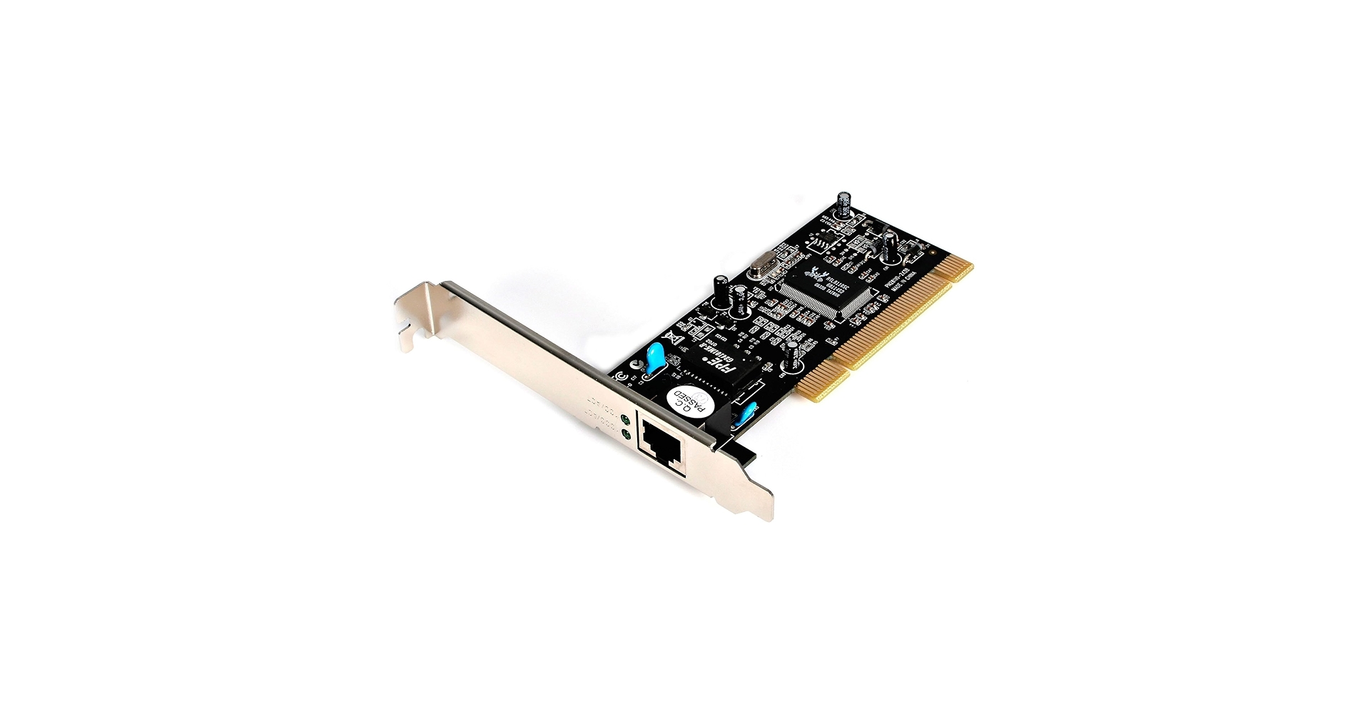

Hi:
Yes, it is PCI, but I don't see that it supports W8.1 or W10.
You may want to go with this one...plus it is gigabit.
Doesn't state that it has support for W8.1 or W10, but reviewers said it does.
https://www.amazon.com/StarTech-com-Gigabit-Ethernet-Network-ST1000BT32/dp/B0000TO0BQ/ref=sr_1_3?cri...
It appears to be based on a Realtek ethernet chip so you can get the W8.1 driver for it at the link below.
Download, unzip and run the setup application from the W8/W8.1 driver file...
https://www.realtek.com/en/component/zoo/category/network-interface-controllers-10-100-1000m-gigabit...
