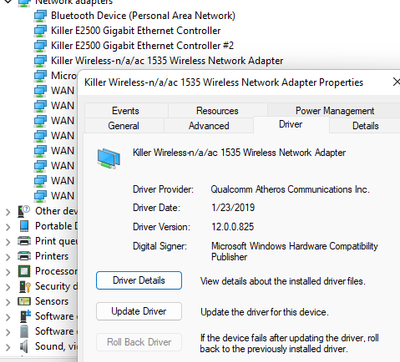

I assume you checked the BIOS and verified it is enabled. If so, then try rolling back the drivers as shown
If the "roll back" is grayed out (like above) then delete the driver and check the option to remove from the drive then reboot.
If that does not work then post back here.
