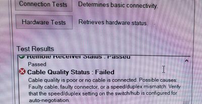

Im running a minecraft server on my Prodesk 600 G4, and it is having this issue. Sometimes when someone teleports it will disconnect the computer from the internet. On the device manager it's saying that the ethernet is connected but there's no traffic. The server doesn't crash or anything, it's just the computer that disconnects. I tried asking for Intel to help but when they ran out of possible solutions they recommended i come here.
Below are some images of the issues I've found so far that might cause it

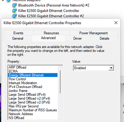

Try the following at the device manager's hardwired ethernet adapter
Power management - do not let system power it off
Device properties: disable energy efficient ethernet
if the above does not help try the following.  Note that Offload enabled means the NIC handles the task, not the CPU.  Some chip designs cannot keep up with the workload and your modern CPU may do a better job.
Try disabling the Checksum offload first then the other offloads
You can try enabling or disabling the jumbo frame.  Normally it should be off
Shutting off the wake on line or wake on pattern match can reduce the burden of work for the NIC
You can look at your modem for broadband errors
Try some speed tests to see if improvements above make a difference
https://www.turnkeyinternet.net/speed-test
and you can use https://www.speedtest.net/
Even if not using Wi-Fi you should check for problem as degraded Wi-Fi indicts a modem problem.
