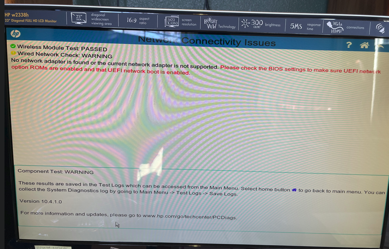

Ran the PC Hardware Diagnostics UEFI Symptoms Test for Network Connectivity Issues indicating it could not find a network adapter.
I'm not sure where in the BIOs to check for the settings since enabling the Network Boot did not resolve the problem and I'm not sure if the issue is with the Realtek Adapter since the Network Check passes one time and fails another time.
