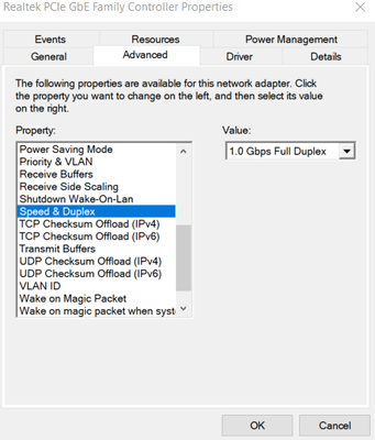

After researching on the internet, I changed settings on my Realtek PCIe GbE Family Controller Network Adaptor to 1GB Speed & Duplex.
No change; still 100mbps.

The Speed & Duplex advanced setting for the Realtek ethernet adapter in my notebook is set to Auto Negotiation, not 1.0 GB/S full duplex like yours is.
You may want to try that setting if you have not done so already.
The Speed & Duplex setting for the Intel gigabit ethernet adapter on my Dell Optiplex 7050 tower is also set to Auto Negotiation.
As you suggested, I changed the speed & duplex setting to auto negotiation; see next.
Changed back to 1.0 GB. See next.
