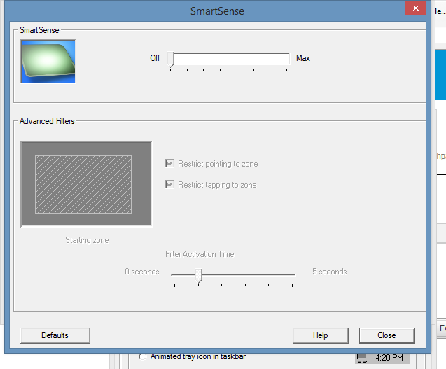

Yeah, I get that about the motion.  But, I'm talking about clicking and moving and typing all at once.  I have an FPS where the mouse "buttons" are the shoot commands.  But, my Envy doesn't have mouse buttons, you just tap on the pad to click.  But, when I'm trying to move and pan and shoot, the tapping function doesn't work; it's like it's blocked in the same way that SmartSense blocks moving the mouse while typing.  For this reason, I was asking if there is a similar setting for tapping to allow clicking while typing.
Your smartsense settings should look like this, then you would be able to click and move the mouse while typing.
The image you uploaded is not visible, it's just a triangle.
As you can see, I've already turned SmartSense off, but it still doesn't let me click while moving and "typing."

But really, it's Windows+S -> Type: Mouse Settings and select the 'Change mouse settings' option that contains a picture of a mouse. From there, click the ClickPad Settings Tab (it has a little icon next to it) -> click ClickPad Settings -> select SmartSense -> some blue gears will appear next to it, click em -> then slide the SmartSense meter all the way to the Left/Off end.....

I've tried all the fixes above and others from different sites, and it just does not work.  Everything in the diagrams match picture perfect...  The mouse still hangs for a second after typing before I can move it, and it still won't let me use the touchpad and keys simultaneously.
I'm having the same problem. I went to the mouse setting and turned off the SmartSense and although there is only a small delay now between typing and using the touchpad, it still won't let me use the touchpad and keys simultaneously either. It's extremely annoying!
