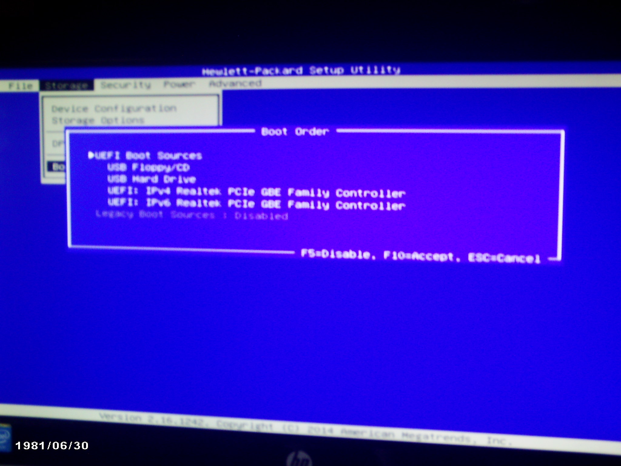

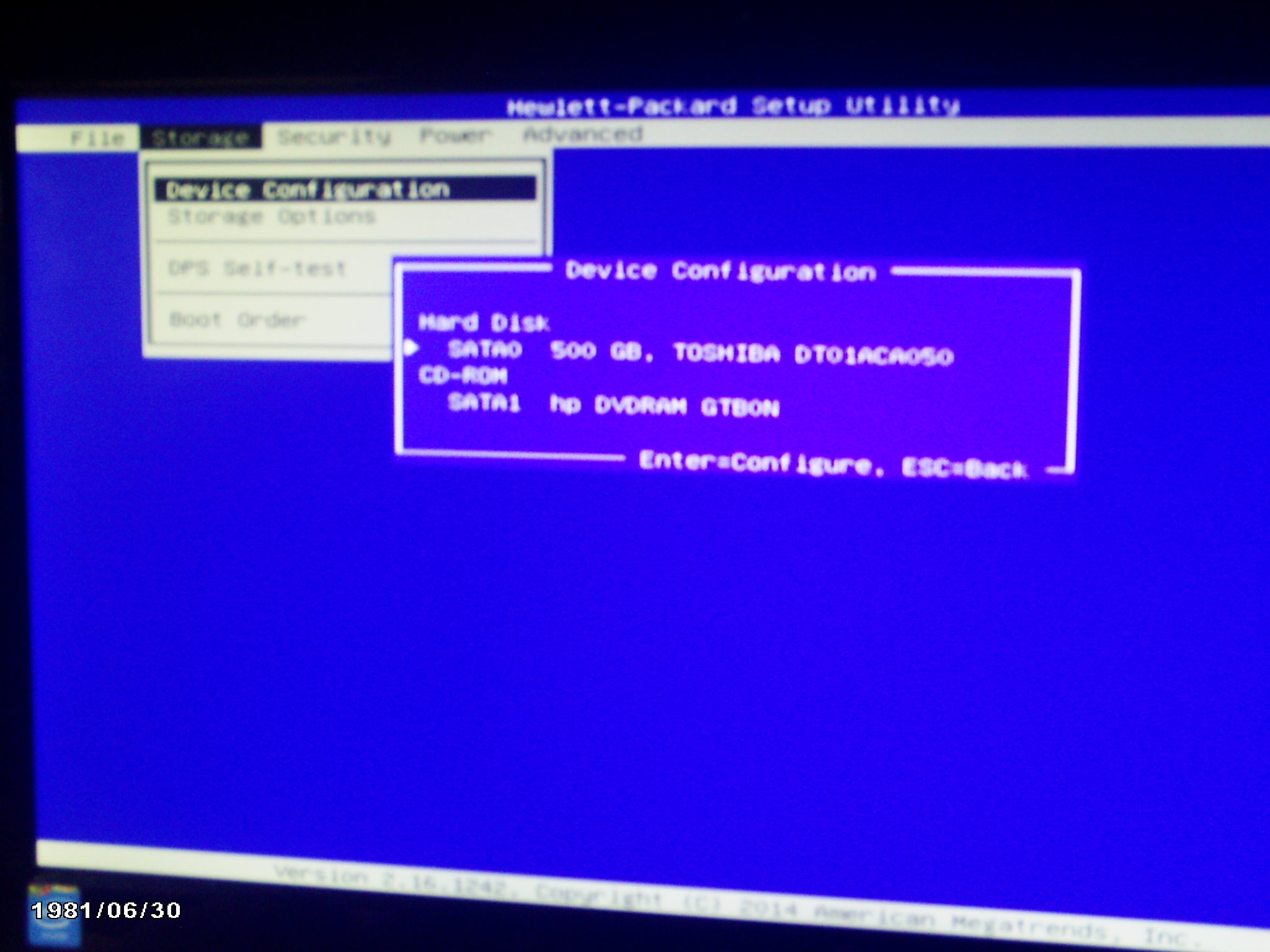

i can not get anything to come up in boot order but device configuration show both DvD & hard drive & when i try boot select (F9) nothing but  Ipv4 & Ipv6 PCIe GBE Famliy controller is all that is listed .
i have tried everything i could find and things i thought of and i still can not get anything to come up to boot from.I have tried the Rufus boot usb to swapping the hard drive & DvD player,reset the BIOS,tried external hard drives & DvD drives and i still have bupkis & legacy support is non existent.The option is there BUT there is no way to enable it.....HP you need to address this !!!!!
Hello mrchuck,
The suggestion that I post was a work around to bypass legacy. When creating your flash drive, you need to make sure it is MBR partition for UEFI. It should be the bottom option in the drop down menu. Then make sure it is formatted as FAT32. Both these options are presented in Rufus. After creating the disk, you can access boot options by hitting F9 and you will see your UEFI sub hard disk. Select this option and you should be on your way. This will not activate Windows though. This is only if you have a valid version of Windows handy.
