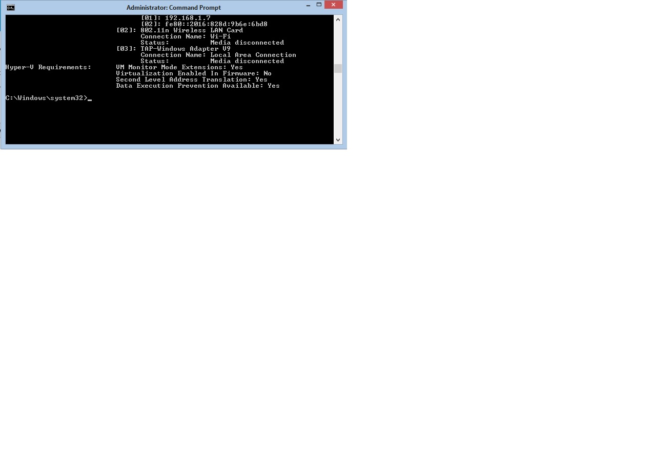

My computer boots in UEFI mode.  I verified this in the System Information. My AMD A4-3420 Dual Core processor supports it and its auto enabled in the processor.   The referenced link shows what it would look like for an Intel based system.  This is what my AMD based system cammand line looks like.  Is there another DOS based command that would give you anything more specific?
