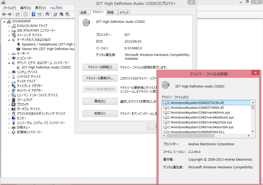

Opened the device manager as follows, but could not find any unknown devices marked out with a yellow question mark.
Even though there is no unknown device, the device I need might be sound driver and clicked the property as follows.
Hardware ID is as follows.
There are tow IDs.

Thank you for your sugestion.
Driver has been installed and upgraded shown as below.
Unfortunately, the mic status "currently unavailable" in the Sound has not changed.

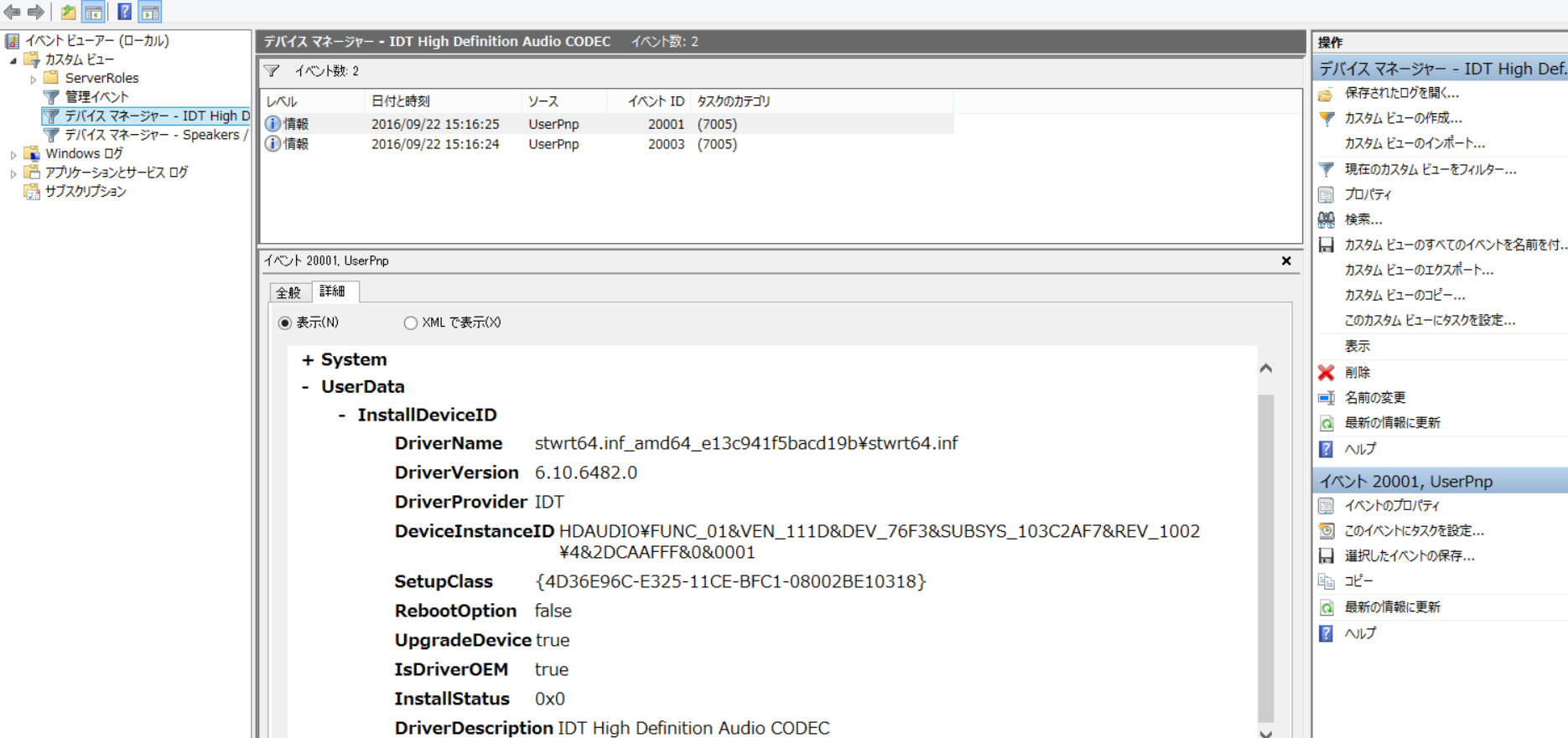

The information listed above in Japanese, is difficult for me to understand.
Let me try to translate to English
" The process to add the service "STHDA"  for device instance ID HDAUDIO\FUNC_01&VEN_111D&DEV_76F3&SUBSYS_103C2AF7&REV_1002\4&2DCAAFFF&0&0001 has been finished  at status 0。
In addition to that, event detail information is as follows.
