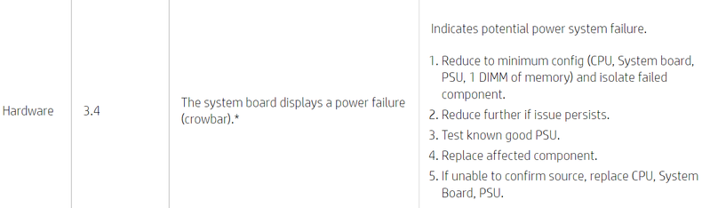

my pc doesn't start up at all, shows nothing on the display when the power button is pressed. it emits a beep code of 3 long beeps and 4 short beeps.

HI @king_diagnostic,
A 3:4 BIOS error code indicates a hardware problem.
Troubleshooting steps are as follows:
You may need HP Factory service if in warranty or local PC tech service to isolate the failing component.
You could try self diagnosis. AIO PCs are difficult to work with. Plus you may need to buy components to find the bad part.
