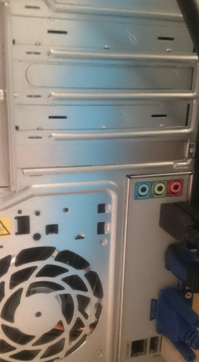

On the back of the computer, there is no socket where is graphics card is installed.

Could you open the PC and take a picture of the inside? There may be a graphics card with no connections because it is switchable. If you notice it appears there is some sort of etching on the bottom slot. So if there is a card in there, it is using switchable graphics...
This will possibly solve the mistery of the phantom video card.
I am not an HP Employee!!
Intelligence is God given. Wisdom is the sum of our mistakes!!
Well, you are absolutely correct that the card has no ports.  It is not meant to have them.  Your computer has switchable graphics.  Basically, this means that the integrated and the video card work together to power your monitor.  When more power is needed than the integrated graphics can provide, it switches to the graphics card.  I hope this makes sense to you.  I believe that HP will be adding more information to the Product Specification page on this situation.  I would appreciate it if you would open the case to verify that there actually is a graphics card available and let me know.

Thank you very much old_geekster for going through all the trouble to find out the truth for me. Really appreciate it.
Yes I did  open (and at the same time voided the warranty ) the case and the graphics card is there.
The automatic switch between the cards is what I suspected how it would work.
