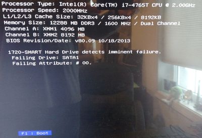

Inital boot image
This is the message that i am getting as soon as I power the PC on. It indicates that SATA1 is the failing drive...Then I hit "F1"  for normal boot up. and then kept hitting "f10" until I got to the HP set up utility.
IMHO...This picture indicates that I have two hard drives and the "SATA1" is the smaller SSD drive
SATA1 is shown as the 16GB SSD device.  Remove it, and your computer will still function.
Replace it, and your computer will function at its maximum data-transfer mode.
