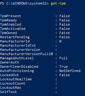

In powershell "get-tpm" has TpmPresent as False:

Here are two pics of running the get-tpm command in Powershell.  For others... that command does not work in the older CMD program when running it as admin, and you have to run Powershell as admin for it to work:
