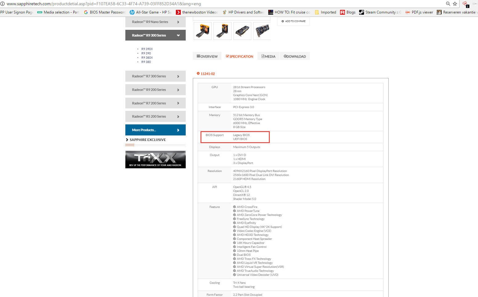

The GTX 1060 isn't working in your desktop PC simply because your PC does not support video cards that do not have legacy BIOS ( that is what your PC has).
The GTX series of video cards have only  UEFI BIOS support. UEFI BIOS is only in newer desktop PCs and notebooks.
If you want a card as powerful as a GTX 1060 or 1070 you will need to look at the AMD Radeon r9 series of PCIe x16 video cards.
Always check the specs to ensure that legacy BIOS is supported. Some manufacturers produce and sell cards that support both or just one BIOS type.
For an example,  take a look at the following Sapphiretechnology manufacturer's specifications image. http://www.sapphiretech.com/productdetial.asp?pid=F107EA58-6C33-4F74-A739-03FF852D34A1&lang=eng
