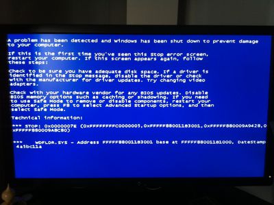

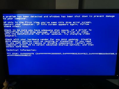

Today i have made a lot of tests. First of all i enabled Boot-time Diagnostic Screen in my BIOS.
1. One hyper X tests on all the slots. Result - blue screen.
And when I insert one hyper X in the first slot I see:
3. With one Hyper X i can open the BIOS Setup utility
4. Then i test 2x4GB (1 kit) in the black and blue memory slots. Result - no beeps, power light is switched on, fans work. And i can see this screen, but the keyboard does not work, so I can not open the BIOS Setup utility.
