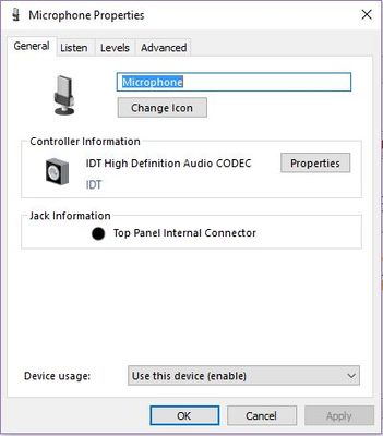

Thank you for your reply.
That is exactly what I have been doing many times. I have tried out two sound recorders and I also used the control panel to check the "listen to this device" checkbox for both Mic and Line In, the mic gives feedback because it is the compters mic and there is no sound for line in. I also watch the meters on the Sound Control Panel. Same result.
When I plug in a 3 level jack/3 wire Audio Cable the Control Panel icon for the Mic does not switch from the internal mic to the mic input jack as I believe it should.  I would expect the "Line In" icon to become active in liue of the Mic Icon when I plug in the audio cable.  The line in icon does not become active when I plug in the cable.  In addition the line in properties does not list a port which seems suspect. It sure seems like this is a Windows 10 problem, as I suspect if I had a mic to plug in I could do what you said and configure the mic port to use an external mic. However, line in is not assigned a port so it never activateds when I plug the cable in.
I am attaching some screen prints.  Logically, the line icon should become active when I plug in the audio cable, just like the headset icon becomes active when I plug in a headset. If that is how it is supposed to work, then shouldn't the properties for the line icon should list the mic/line port?
Thanks again for your help!
