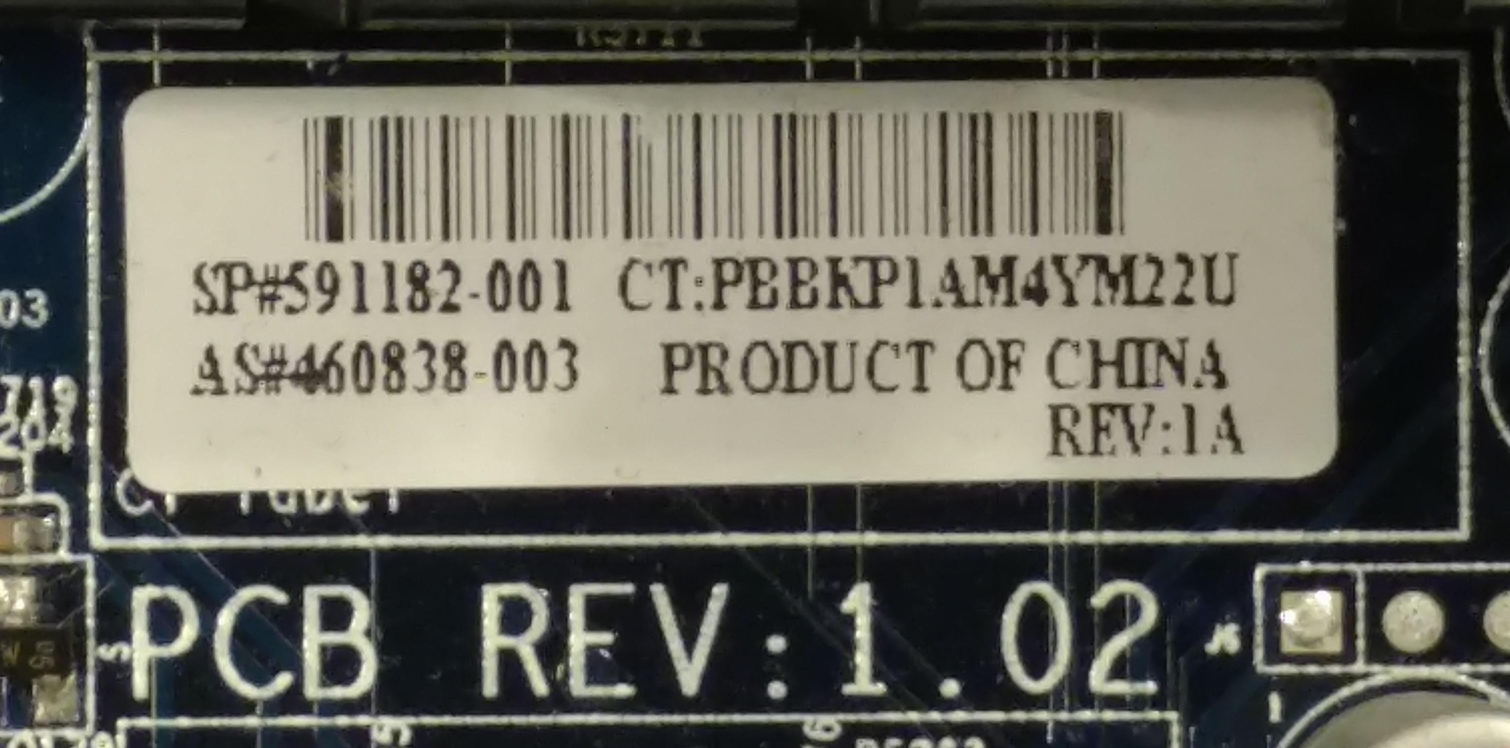

Hi.  Yes, replacing the motherboard was the solution.  I tried different video cards in other slots, changed the memory around, and none of it worked.  The PC also produced patterns of beeps and flashing lights that were not in any manual.   So if these are your symptons, buy a new motherboard.  It took about 45 min to pull everything out and replace it.  You should be careful regarding static when you do it.  If you've not been trained, basically, don't pick up any chip, card or board without first touching the chassis to ground yourself.   A static discharg can be over 500V and damage the electronics.  If you can,  pick up the memory chips in a holder first, and then touch the holder to the chassis, and then touch the chip.  This prevents any current flow from going thru a pin or wire trace.
Also, there are two barcoded numbers on the motherboard, make sure you get a repalcement that is identical to what you have.  The second number is the cmos board revision, and you want to make sure what you've got in your box is compatible.  Not every knows this, even some of the folks at HP parts were unclear about the differences.  I you want, you can give me a call at ( 2 one 3)   2 one seven - seven seven 64.  Stephen  I'm in Los Angeles.z800_SN-AS.jpg
