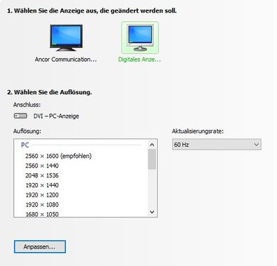

Sometimes (randomly) my HP 25x won't detected or recognized by my Windows/Computer and only the ASUS  works. WHY!?

Nvidia shows this: Why WQHD and DVI connection ?
Nvidia settingsNvidia settingsNvidia settings PhysXNvidia settings PhysX
