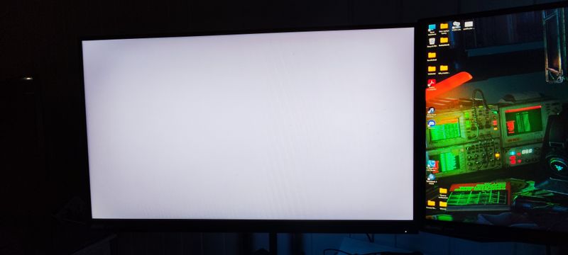

I came across a problem when i changed the 27I as my secondary screen in my setup. When my computer goes to sleep and wakes up again the 27I is almost completely white with some vertical colored lines and it won't show any feed from the computer (The on board settings menu will show up normally when the screen button is pressed but the Display feed is blank from the computer as in no cursor, desktop or apps... nothing.)
The screen is working normally when i start the pc and i've had no problems like this when this was my primary screen but the moment the screens go to sleep on this configuration the problem starts and won't stop before i reboot the pc. (I have tried removing the dp cable, swapping the DP cables around between the screens, removing power cable for an hour from the HP screen but to no results.)
I had before a 60 hz office monitor as my secondary screen and the Omen 27I as primary but when i swapped the Odossey as my main screen and the 27i as secondary the problem started.

Close up from the linesClose up from the linesBlank feedBlank feed)
