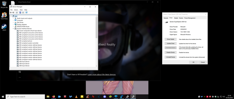

since last windows 10 update been unable to get my hp reverb g2 working and watching the drivers in device manager generic superspeed usb hub switches back and too until MRP software come up with error code 7-7 - as you can see from the pictures the usb starts switching back and too and and it stops with the error code 7-7 until i remove the power and plug it back in and starts again.

Ive have used all usb 3.1 ports and still the same problem first thing i did 😞 And it just switches back and too lick I said what ever port is used until the error message come up.

Screenshot 2022-05-21 at 23-58-43 zkibu8vni4y81.png (WEBP Image 2560 × 1080 pixels) – Scaled (63%).pngScreenshot 2022-05-21 at 23-58-59 vhxdwhtqi4y81.png (WEBP Image 2560 × 1080 pixels) – Scaled (63%).pngScreenshot 2022-05-21 at 23-59-11 upn2m5bti4y81.png (WEBP Image 2560 × 1080 pixels) – Scaled (63%).pngScreenshot 2022-05-21 at 23-59-29 5q9vg7qwi4y81.png (WEBP Image 2560 × 1080 pixels) – Scaled (63%).pngScreenshot 2022-05-21 at 23-59-41 7mynau7yi4y81.png (WEBP Image 2560 × 1080 pixels) – Scaled (63%).pngScreenshot 2022-05-21 at 23-59-56 1ygfy7u8j4y81.png (WEBP Image 2560 × 1080 pixels) – Scaled (63%).png
