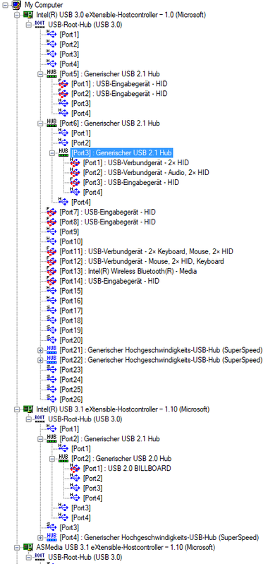

My USB Tree looks like:

I did this already several times in various sequences and port changes without success.
Quickest fix will probably be to RMA the unit as HP Support only suggests the standard troubleshooting tipps like "try another USB port, deinstall drivers, etc.".
In my case I will go for an RMA now.
