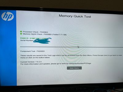

Could be a memory or a boot drive problem. Try running HP UEFI Startup Diagnostics.
Start the PC Tap "ESC", select "F2".
Run system and component tests.

Every sing test passed
Also ‘my current version of diagnostics is not up to date’ that’s what it says in the UEFI page.
Any help?
