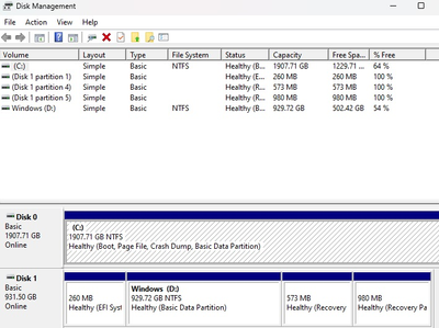

I have an HP Omen Obelisk 875 Desktop that I purchased 3 years ago, and recently upgraded the 1TB HDD to a 2TB SATA SSD.  I installed the SSD as the C drive with the original 1TB HDD as the D drive.  I used a Windows recovery USB stick to install Win11 on the new SSD, and everything went smoothly.  After I transferred my files from the HDD to the SSD, I powered off the PC and put a 2TB HDD as the D drive for extra storage.  However, when I turn the PC on now, the BIOS does not see the SSD as a bootable drive.  It only sees it as a non-RAID drive and will only let me boot to Windows if I also have the original 1TB HDD installed as a secondary drive.
I have tried turning off Secure Boot and turning on Legacy Boot in the BIOS, but it still doesn't seem to see the SSD as bootable.  I tired updating the BIOS since the current version is from 2020 and there is an F.27 update from 2021.  However, it never actually seems to update as the version is still from 2020.  Any suggestions and help would be greatly appreciated.
I was able to resolve the issue.  The issue was right in front of us the whole time.
I checked in Disk Management again and realized that the new SSD didn't have an EFI boot partition.  I used CloneZilla to copy the EFI partition from the old HDD to the new one, and now the SSD boots without the original drive installed.  Thank you for your help!

I have looked at the volumes using Disk Management and DiskPart but it looks correct.

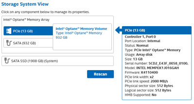

Could this be an issue with the original HDD not being connected while the Intel Optane memory still is?  I removed the Optane memory from the motherboard and disconnected the original HDD, but still have the same problem of no boot device being found.  When the original HDD is disconnected, but the Optane memory still is, there is a message in the BIOS about the Optane memory volume being incomplete.
The SDD is working fine except for not being able to boot from it.  I am currently typing this message from Win11 on the SDD, and can boot to windows on it as long as the original HDD is also connected.  There just appears to be a setting somewhere in the BIOS that is not seeing the SSD as boot.
For more information, here is what is shown in the Intel Optane memory app.
Intel Optane PCIe is on Controller 1, Port 0
The original 1TB HDD is on Controller 0, Port 2
The new 2TB SDD is on Controller 0, Port 0
There's an option to disable the Optane PCIe Memory, but I'm not sure what impact that will have on the system.
Essentially the Optane disk just speeds up memory access.
