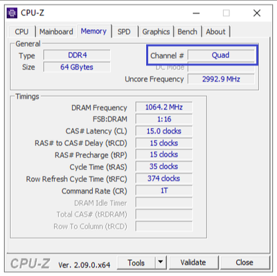

I used a matching 4 x 16GB Samsung M393A2K43BB1-CTD6Q DDR4 PC4-21300, 2666 MHz, ECC, Registered DIMM (RDIMM), dual-rank (2Rx8), 288-pin) server RAM kit, which runs incredibly well in "quad mode":
Link: HP Z440 Workstation Performance Results - UserBenchmark.
You need to install 4 x 8GB RAM in a particular slot # order, the same configuration as my 4 x 16GB RAM:
