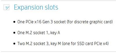

The specs show one slot is designated as PCIe 3x4, so it makes me suspicious that the other slot is sharing a couple of lanes for Sata perhaps? HP doesn't make it clear with their wording. 😡
So I don't know if it will run full speed or not as I have not had anyone report back on any speed tests, etc. (I don't have access to that model).  But with prices as they are currently, you can get either an x2 or x4 stick for roughly the same price now days so I wouldn't worry about cost.
