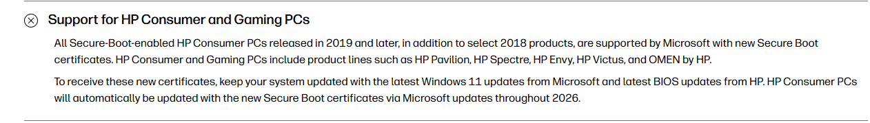

The information you shared is helpful. However, based on the HP guidance shown in the provided documentation, Secure Boot-enabled HP Consumer and Gaming PCs released in 2019 and later are supported for the new Secure Boot certificates, and the Windows UEFI CA 2023 certificates are expected to be delivered automatically through Microsoft Windows updates during 2026, provided the system is kept updated with the latest BIOS and Windows 11 updates.
Click here for more information.

Thank you for the information. I understand that HP Consumer and Gaming PCs released in 2019 and later are supported for the new Secure Boot certificates, and that the certificates are expected to be delivered through Windows updates.
