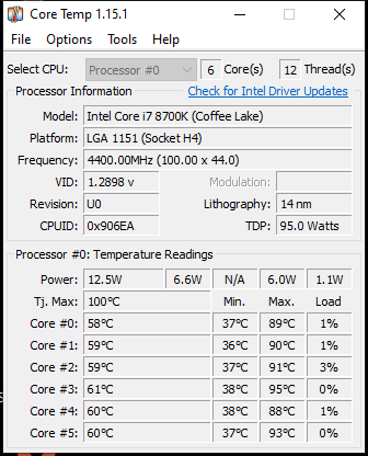

omen 880-130
my pc is:
intel core  i7 8700k
32 ram
rtx 2080 ti fe
when I play cod modern warfare the cpu temp it come to 95 degree
I don't know is this normal or too high
You are welcome, @Badr_alharbi!
The Max temps are not a problem at this point, but if they reach 100C the processor will begin throttling.  This reduces performance.

@Badr_alharbi , welcome to the forum.
The Tjunction temperature for the 8700K is 100C.  Here is the definition of Tjunction from Intel:
"Tjunction max is the maximum thermal junction temperature that a processor will allow prior to using internal thermal control mechanisms to reduce power and limit temperature. Activation of the processor's thermal control system may cause performance loss as the processor typically reduces frequency and power to prevent overheating. The goal for a system builder or a do-it-yourself (DIY) end user is to design a platform configuration that keeps the processor under the Tjunction max threshold during heavy workloads to maximize performance of the system.
The benefit to a user is that many third-party utilities can monitor the digital thermal sensor (DTS) on the processor die to see how close the system is approaching the Tjunction max temperature without any destructive testing. We recommend that end users look up information on the product specification page (ark.intel.com) to aid them in system assembly. Original design manufacturers should consult the nondisclosure agreement (NDA) documentation available to them for full details."
Your temps are bordering on Tjunction territory.  I suggest that you clean the inside of the case thoroughly to see if that solves some of your problem.  Pay particular attention to the fans.  If they are very dusty this could cause them not to cool properly.

The pc from inside is too clean I always use the dust clean spray, also i read in the internet that the max temp Column in temp core app is not big problem, but I don’t sure about that.
i have also one question If three fans are placed on top of each other in pci slot bad or Dangerous?
thanks for your help
