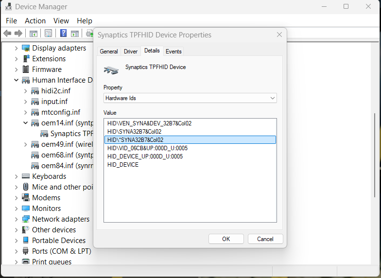

- information 12C HID Device
In the 'details' tab, copy the hardware ID marked with an asterisk in the Microsoft Update Catalog (like this example).
After downloading the driver from the Microsoft Update Catalog, extract the .cab file, then install it as usual via Device Manager.
