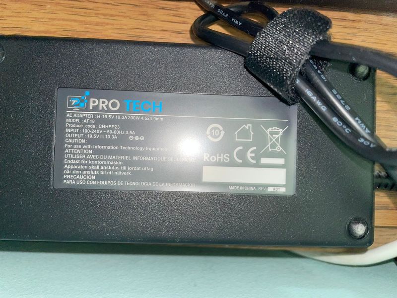

I just bought a new AC ADAPTER that is not original ( it has the exact same specifications ) and it says " The Smart Adapter power rating is below system requirements . System is runing in reduced performance mode. "
Is there any way to fix or bypass this ? I was looking everywhere for an original AC ADAPTER but there are none . HELP ME PLEASE
You will need an HP 200 W Smart AC power adapter that has HP part number L00818-850.
The power rating of your new power adapter must not be providing 10.5A and 19.5 V, if you are seeing that error message.  P=IE  10.5A x 19.5 V= 204.75W

this is the ac adapter , with those exact values . i ll try the L00818-850 and come back with feedback
OK.
Be aware that the proper PSU  matching the HP part number will have a blue tip on the barrel plug.
That is an HP standard.
As I said, the "values" that are marked on the PSU, may not be actual values.
That is likely to be what is triggering the warning message.
