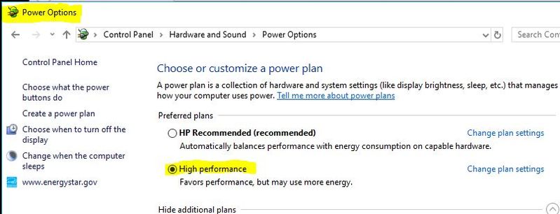

And finally, this might help a little, Windows Power Options...

Also i can't try high performance battery  because i don't have this option in my laptop i only have hp recommended..
Wanna help please 😭😭 it's a new laptop 😔HP recommended  only no high performanceHP recommended only no high performance
The power plan isnt mandatory, besides you can simply create a custom plan with the Change Plan Settings button in the picture.
