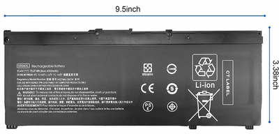

According to HP PartSurfer, the OEM HP battery part number is: 917724-855 ("Assembly-battery 4C 70Wh 4.55Ah LI SR").
A suitable non-HP replacement laptop battery would be the SR04XL model, such as this quality example: Aluo SR04XL Replacement Laptop Battery for Hp Pavilion 15-CB000 Power 15-CB000 15-CE015DX 15-CE000 1....
Please check your battery, should look like this:
