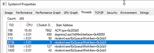

Hello, I have syrious problem with my HP Omen 17 unit - System process takes 30% of cpu during idle time. Under load it takes effect on games FPS, screen stuttering etc.
Problem occurs at first boot (after about 5-10 min shutdown). After 1-3 Windows restart it disappears.
But it's unacceptable situation, since I need this pc for work (where time of reaction matters, so it cannot be just restarted each boot).
At first it occured as ACPI.sys+0x42f50
After Windows update to 1809 it shows as ACPI.sys+0283d0

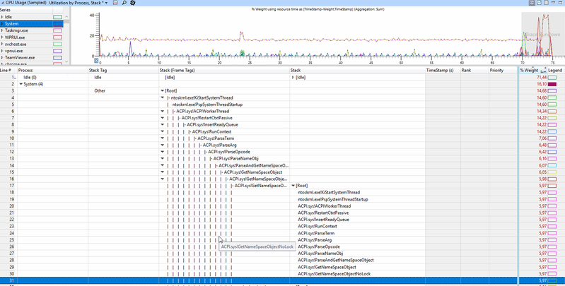

- Run Diagnostics with Windows Performance Analyzer
- LatencyMon Home Edition shows that ACPI.sys works incorrectly

- task manager:
- from procexp64:
- from Windows Performance Analyzer:
