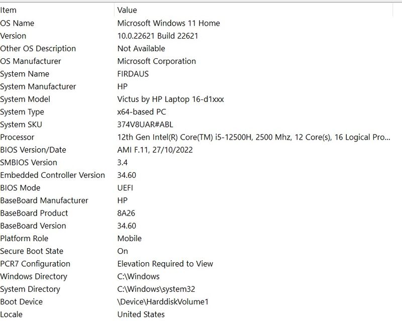

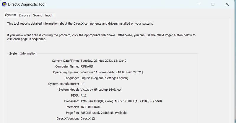

hello a few weeks ago i bought this victus laptop, there is a problem i had when i play games using nvidia driver that always crash and bluescreen. then the driver always nvidia always dissapear so it just show GPU from intel iris XE ..
i tried to find support here and read the comunity forum that had same problem with me.
i hope HP want to fix this problem. or anyone comments please thanks in advanceSpek.jpgi512500H.jpgNo rtx.png
