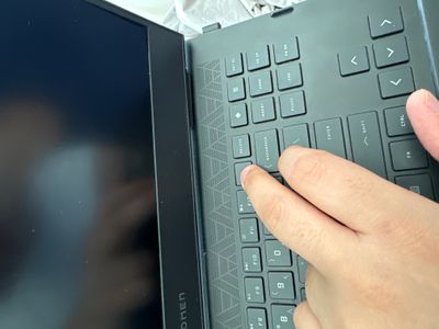

Hello i have hp omen 16 i buy it from one year i used it for design programs yesterday i turned it off and left it about 12 hours then i plunged it to ac today morning and there is no answer no charging light no turning on nothing at all this problem leads me to madness. If anyone knows what is wrong and can explain why I will be grateful. Thanks
