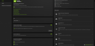

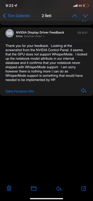

Hello. I'm going directly to my problem. Even though my graphics card is compatible, whisper mode cannot be turned on on my device. This problem started with Geforce Experience version 3.27. Even if I installed 3.26, I could not go back because it did not install the driver. I contacted the support service dozens of times in version 3.27, we tried all kinds of ways, but we were not successful. My device is HP Victus 16 S0031NT model. Even when we put it in performance and balanced mode as in the guides in the device's own OMEN program, it did not work and it constantly gave the impression that my graphics card was not compatible. Now, there is no whisper mode directly in Geforce Experience 3.28 version. Even though it does not appear in the features section, it was at least visible before and gave a warning sign that it was not compatible. Now it doesn't exist. I've been doing operations without whisper mode for about 7-8 months and sometimes the fan noise really annoys me, please find a solution to this. Thank you, I will add the attachments you want and more below.
