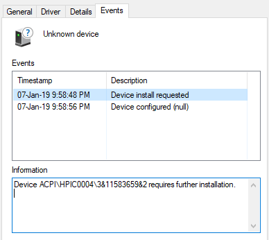

I have an issue that i disscused before in another post about screen turning black during games and sound buzzing .. so i updated bios and after i did that the problem didnt happen for a day then the next day i got it again but i got these 2 unkown drivers errors that i didn't have before updating bios 12355.PNG12345.PNG1234.PNG

Hi:
Here's the other one attached below.  Install the same way as the HPIC0003
2nd one worked too 1`344.PNG.. may i know are these drivers so essential that they might be the cause of my crashes ingame? the black screen and buzzing sound
