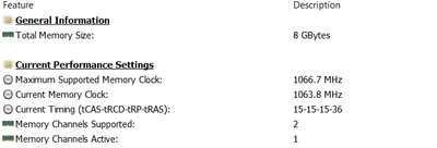

Now I more confused... why the speed of my memory says 1066mhz?  shouldnt be 2133 each module?.
Here´s the info from the tool.
Looking forward to hear from you soon.
Hi:
OK, so you know that HP installed dual ranked memory which means that you would want this chip of the two you posted.
HYNIX 8GB DDR4 2133MHZ PC4-17000 260-PIN1.2V SODIMM NOTEBOOK MEMORY HMA41GS6AFR8N-TF at Amazon.com
The clock speed...
The DDR4-2133 MHz, 2400 Mhz, etc is the dual channel speed.
The 1066 MHz is the single channel speed.
When you have two memory chips installed, you multiply the 1066 x 2 and you will end up with 2133 MHz and when you run the tool and you are on that summary window page, it will show you the 1066 MHz and the Mode the memory is running in.
With a single 8 GB chip, you will see 1066 MHz in Single Channel Mode.
With 2 x 8 GB you will see 1066 MHz in Dual Channel mode.
When you have two memory chips, you always have to multiply the speed by two.
Every tool like this one will report the same thing (half the advertised memory speed).
Hope that clears things up for you.
This is probably better than the HP support.
Thank you so much.
