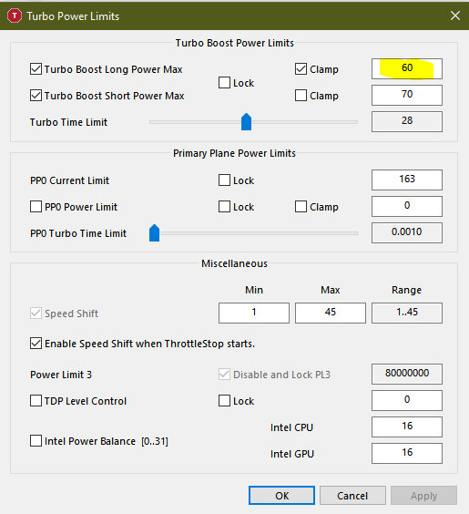

Hi, I recently bought the Omen 17 with I7 9750H + RTX 2070. Here's what I did to achieve max. performance and min. heat.
Pls. note - whatever you do, it's on your own risk - however undervolting usually should not harm your system. If you go to far it just reboots and loads the defualt settings.
1. (and this is most important) - replace thermal paste on both the CPU and GPU. It's a shame what HP does at a 2k€ maschine. The thermal paste is of very poor quality and applied too thick. Takes some time and alcohol to get it clean again.
Re-pasting gave me between 10-20 degrees of less heat(!!!)
2. In Omen Command Center set Power-Settings to max.
3. Install and run Throttlestop (see settings below)
4. On the FIVR Tab offset CPU Core and CPU Cache by -150.4mV (it works fine on my maschine however it you're receiving crashes, you can go down to -140mV or even -125mV).
5.  Open the TPL tab - this is the most important one. Set Long Power Max to 60 Watt (this only works it you followed step 2, otherwise you're limited to 45 Watts). Short Power Max can be set higher, but this does not make a difference for me, it just increases heat and Throtteling)
With those settings, my system runs stable and quite. Cinebench R20 gives me a score of 2788 - which is significant higher than the 22xx with default settings. Temparature stays around 70-75 when playing COD. Even with Cinebench and other Stress Tests (AIDA64) temperature hardly exceeds 80-85.
