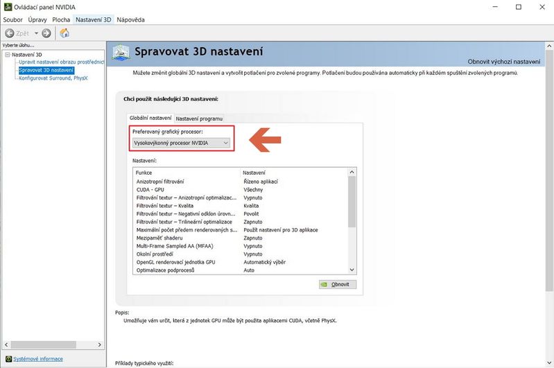

His question: Did you turn off the Nvidia Card in the Nvidia Control Panel?
My answer: No, I never did. But I followed your recommendation and turned on Nvidia graphics permanently.
See picture:
Then:
I restarted my laptop, checked Nvidia's graphic that she is turned on and checked the OCC. OCC still shows only two modes :--(
