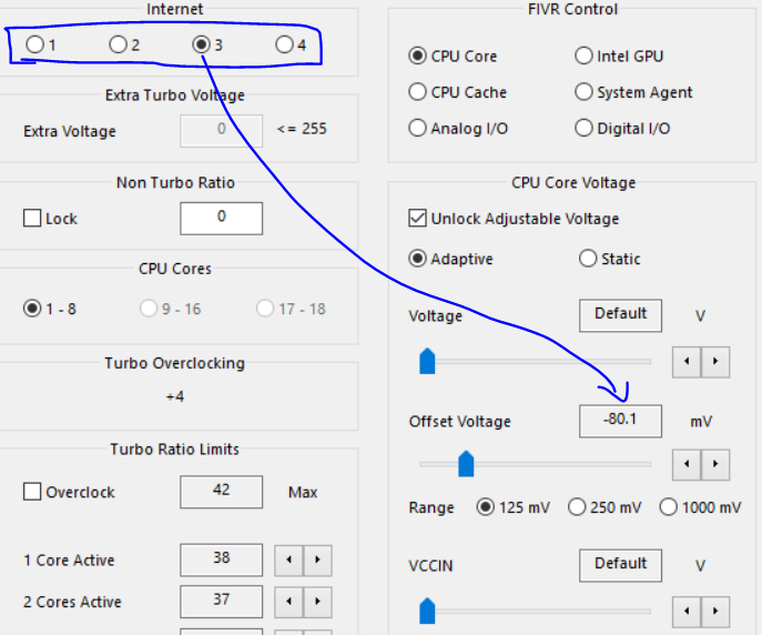

i have a question, there are four circles at left top corner, and the second is game. What happens when i undervolt it??
Those are profiles where you can save and load your settings.
When you adjust your undervolt, at the left top corner you can see on which profile you are actually saving the changes on.
Now, at the Throttlestop menu, when you click on the specific profile, it will "load" your Adjustments or in my case, the -80mV Offset that I configured.
Also, don't be confused by the profile names. They are pretty much random and you can change the names under "Options". In my screenshot below, I changed the names to "Profile Name 1" and so on.
