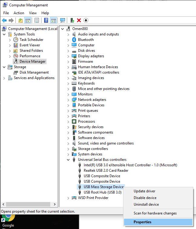

I will add to Eddy's post ^
Also try going to the Device Manager (type Device Manager in the Search bar) and navigating to Universal Serial Bus Controllers.
Expand the arrow and right click on the USB Mass Storage Devices in question and choose Properties.
Then go to the Power Management tab.
Uncheck the Allow the computer to turn off this device to save power box.
IF that does not work, in the Device Manager you can also right click on Intel USB 3.0 Extensible Host Controller and uninstall it. Reboot the computer and it will automatically reinstall itself.
Hope that helps.
