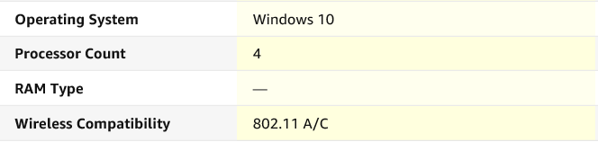

So, I got this laptop a while back, but it only has 4 GB of RAM. (just regular RAM) So what type of Ram should I get for this problem?
