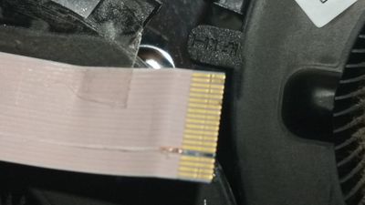

Out of curiosity I disconnected the cable that connects the mini card (with the power button) to the motherboard and found out what looks like a damaged pin. (First i thought it was me damaging it by removing it but it seems rather unlikely)
It almost looks burned.
My theory was that the computer would be sending signals to turn itself off or something.
Its a 20 pin cable ( i believe its 0.5mm pins)
I ran out of theories of what possibly could be causing the computer to shut down.
Could this little cable be the cause of the computer shutting down?

I did check the voltage coming out of the pins and it's about 5.12v on the 4 pins on the right and the "burned pin" also gives about the same voltage.
The next 4 pins on the left give about 3.33v
Also you can see the oxidation on that pin, where it's supposed to be insulated with plastic. The multimeter catches current from there too, i don't know how bad of a sign that can be
