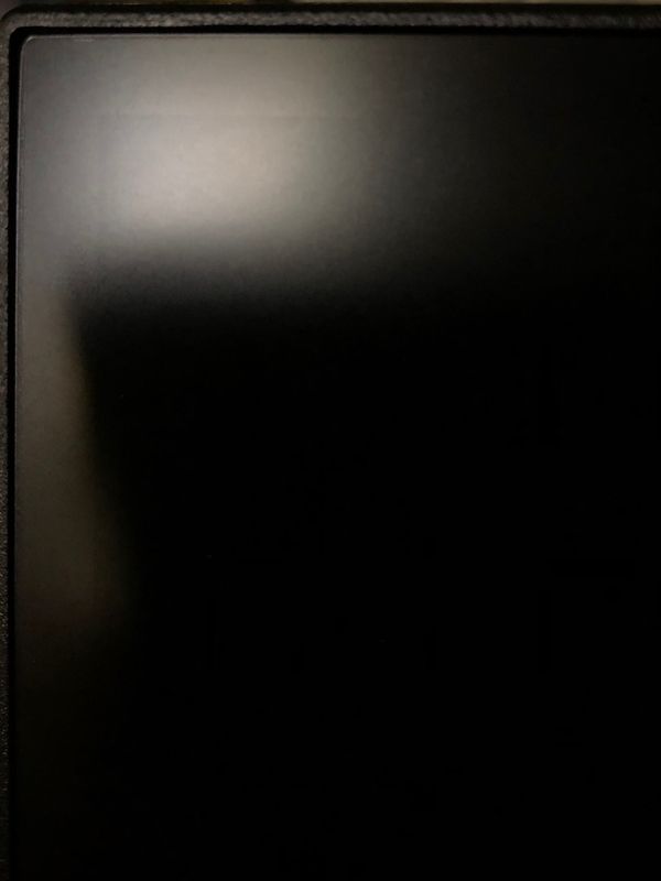

A picture of the monitor on and showing the border is here:
border on left and top borderborder on left and top border
Here is a picture of the monitor "off"/in energy saving mode are here and you can actually see this display border (but very faint) which is making me wonder if it's just a bad panel/limitation on the panel itself.
in energy saver/off - note faint outline of borderin energy saver/off - note faint outline of border
The difference is that I am connecting this monitor to a 2019 Apple MacBook Pro (so the options for solving in the article don't apply  - it is talking about underscanning as a result of NVIDIA or AMD driver configuration), running MacOS 10.14.4 and have tried connecting via Mini-DisplayPort to DisplayPort, Mini-DisplayPort to HDMI, and HDMI to HDMI all with the same result.
The pictures on the website, box, and indeed the display model at Best Buy were showing an image on the panel that extends from bezel to bezel/edge to edge on all 4 sides - in my case oddly the image only extends to the bottem edge/bezel. The image, colors, brightness, contrast is all otherwise fine, that's why I assumed it was an image adjustment/configuration issue -and wanted the manual. Unfortunately the monitor will only let me select the sharpness adjustment in the image adjustment menu, so I'm just at a loss.
thanks for your help, JM

We have got an update from the R&D team and they would like to know few more details:
1. What is the resolution that is set on the computer?
2. Is it matching with the Maximum resolution of the monitor that can be supported.
3. Is this happening on any particular app or screen or with every application.
4. Could you please share the screenshot of the monitor screen to understand how much of the border is visible.
As per the user guide of the HP 27q 27 inch display, the viewable image size is 68.47cm (diagonal) even though the display size is 71.22cm.
And the maximum graphic resolution is 2560 x 1440 (75Hz).
http://h10032.www1.hp.com/ctg/Manual/c05698839
Waiting for your response!
