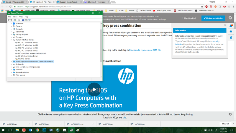

I did all that was recommended in this post to no effect on Saturday evening 6/2.  Had to give up as it got late. Some of the suggested downloads did not work for me - see pictures below. Also discovered I don't have the HID Touchscreen driver and thought that was disconcerting.
Next day touchscreen was still not working. In looking up overheating problems I stumbled upon a few suggestions and did a reboot switch the mode from "Performance" to "Balanced" and for some reason after that the touch screen worked again. Very weird. Will keep HP updated on if this is an issue again. Fingers crossed!
firmware update not working.pnggraphics update not working.pngno HID Touchscreen driver.png
