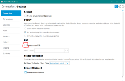

Hello, I know that the subject of remote USB has been discussed many times, but I can't find a solution.
I have the problem that after installing the receiver, the check mark for Remote USB is not set.
I have reinstalled the receiver what feels like 1000 times, including different versions, older versions, etc. But remote USB is not switched on. What else can I do?

Hello, The following versions are in use: ZCentral Remote Boost 20.3.1.8860, Windows 10 Enterprise 22H2.
But the problem is independent of the version of the Remote Boost. I have the same problem with HPRGS 7.7 and the problem is only on the receiver. After installing the receiver, the check mark for Remote USB is not present and the field cannot be operated.
