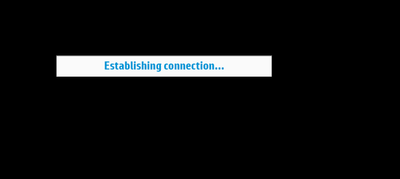

Brand new system, installed the latest version (20.1.2) of the Sender on the 4R workstation and latest receiver on my Elitebook. Every time I try to connect I get stuck on establishing connection. Remote desktop works perfectly fine.

If your sender is Windows and you that the Quadro RTX 4000, try using our headless EDID property in the rgsenderconfig file.
It is located at C:\Program Files\HP\Remote Graphic Sender. Below is the property you will want to enable. I have shown the property enabled.
## Load an EDID on headless Windows system with Nvidia graphics. Once this property is enabled
## this EDID will not be unloaded until the property is disabled.
Rgsender.Compatibility.Displays.ForceEdidOnHeadless=1
Make sure you have editing privileges to this file, do not do a SaveAs or you will have other issues. After making the change, save the file, and restart the sender service, or reboot the system to have the change take effect. Make sure that you do not have any displays attached to the sender, or any EDID files loaded. Our property will not load.
Let me know if this resolves the issue or not.

If a display is attached and turned off, you will most likely get the black screen because that is what Remote Boost sees. Did adding the headless EDID property help? I have used this property even on senders that have a display, but are turned off and the EDID from the display is no longer visible.
07-23-2021 06:34 PM
For Quadro's with no displays attached use the headless mode setting in the config on windows. That's what we use for our Z2's and Z4R's.
For any other video cards like GTX1080 or RTX2080 and no displays attached we use headless adapters attached to the servers to emulate monitors and that should work.
